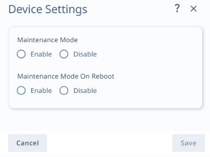

  2. In the Devices page, select Device Settings from the Actions column (actions column icon) for the device you want to update.
    device settings window
  3. Configure Device Settings:
    • Activate or deactivate Maintenance Mode
    • Activate or deactivate Maintenance Mode on Reboot.
  4. Select Save.
